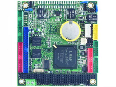

型号:VSX-6156
  产品详细
    SoC DM&P SoC CPU Vortex86SX- 300MHz
  Real Time Clock with Lithium Battery Backup
  Cache L1:16K I-Cache, 16K D-Cache
  Bus PC/104 standard compliant
  BIOS AMI BIOS
  System Memory 128MB DDR2 onboard
  Watchdog Timer 0 & 1 Sets Software programmable from 30.5 ?sec. To 512 sec. x 2
  sets (Watchdog 1 fully compatible with M6117D)
  LAN Integrated 10/100Mbps Ethernet
  Realtek 8100B 10/100Mbps Ethernet Controller Half/Full Duplex Capability
  Flash Disk Support Onboard 2MB SPI Flash Disk
  MSTI EmbedDisk Module (16MB and above)
  I/O Interface Enhanced IDE port (UltraDMA-100/66/33) x1
  RS-232 port x3
  RS-232/422/485 port x1
  USB port (Ver2.0) x2
  Parallel port x1
  16-bit GPIO port x1
  10/100Mbps Ethernet port x3
  Connectors 2.0mm 44-pin box header for IDE x1
  2.0mm 26-pin box header for Printer x1
  2.0mm 20-pin box header for 16-bit GPIO x1
  2.0mm 10-pin box header for USB x1
  2.0mm 10-pin box header for RS-232 x4
  2.0mm 8-pin header for Ethernet x3
  2.54mm 7-pin header for Redundancy Signal x1
  2.54mm 5-pin box header for Keyboard x1
  2.54mm 5-pin box header for Mouse x1
  2.54mm 4-pin header for -5V, -12V, +12V, GND, DC-in x1
  2.54mm 3-pin header for RS-485 x1
  2.54mm 2-pin header for Reset x1
  2.54mm 2-pin header for System-Fail-SW x1
  1.25mm 6-pin wafer for JTAG x1
  Power Requirement Single Voltage +5V @ 390mA
  Weight 84g
  Board Size 90 X 96mm (3.54 x 3.77 inches)
  Operating Temperature -20°C ~ +70°C
  -40°C ~ +85°C(Optional)
